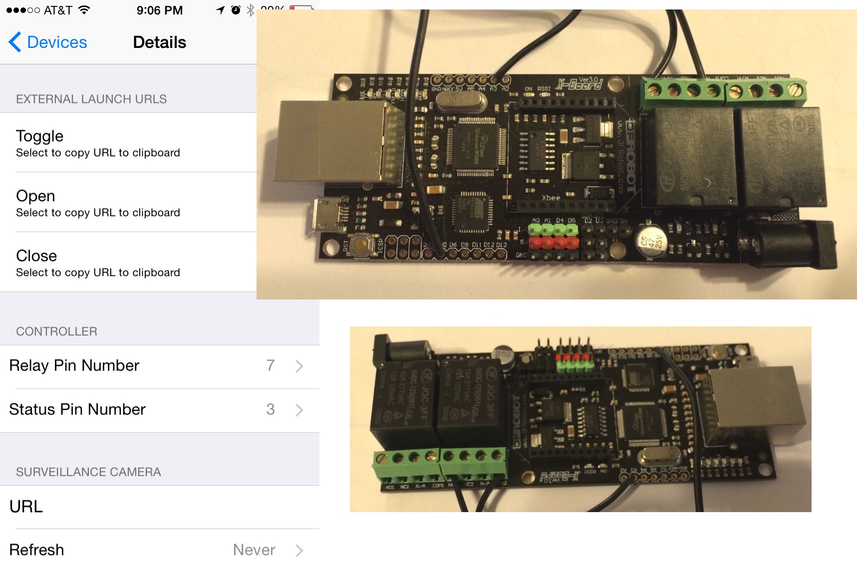

Hello! First, thank you for such a great project! I've just received my DFRobot XBoard Relay board today (replacing my Ethernet + USB & 4 Relay board because the network port got fried). I can get the 2.4 software to engage the relay D7 (NO2/COM2) just fine and the garage door goes up and door great. However, this is where (as in other posters) run into an issue with the sensing pins. I have my door sensor connected to analog pin 3 (A3) and GND (exactly as pictured within your step-by-step guide). I tested the sensor wires that go into the board with a meter and when the door is closed it's grounded, when the door is open, there is no connection--therefore, I know the wires are good. The more I look into it, I noticed in the web browser it shows the following, no matter what the door is at (open or closed). I believe the "statusPin" values 253 and 27 are not correct. I have my iOS app set with D7 and A3 for the app and the app shows an Unknown status for the door (doesn't know if it's open or closed, but it will open and closed it/engage the relay).

Pictures of my board, wiring, and app config are attached.
On a side note, could I not connect the door sensor to the GND terminal hole that's on the same side as the A3 terminal hole? in your instructions you connected one wire to A3 and the other side of that sensor to the GND on the opposite side of the board (see my pictures too). If I can connect them to the same side of the board, it makes for a cleaner wiring install. Thanks.

Thank you! I have confirmed that the latest v2.4 corrects the issue with the status pins. Everything works wonderful! My garage door opens and closes and senses the correct open/close status. Following your instructions in conjunction with this v2.4 update (1/8/2015 edition), the door opener works as intended.

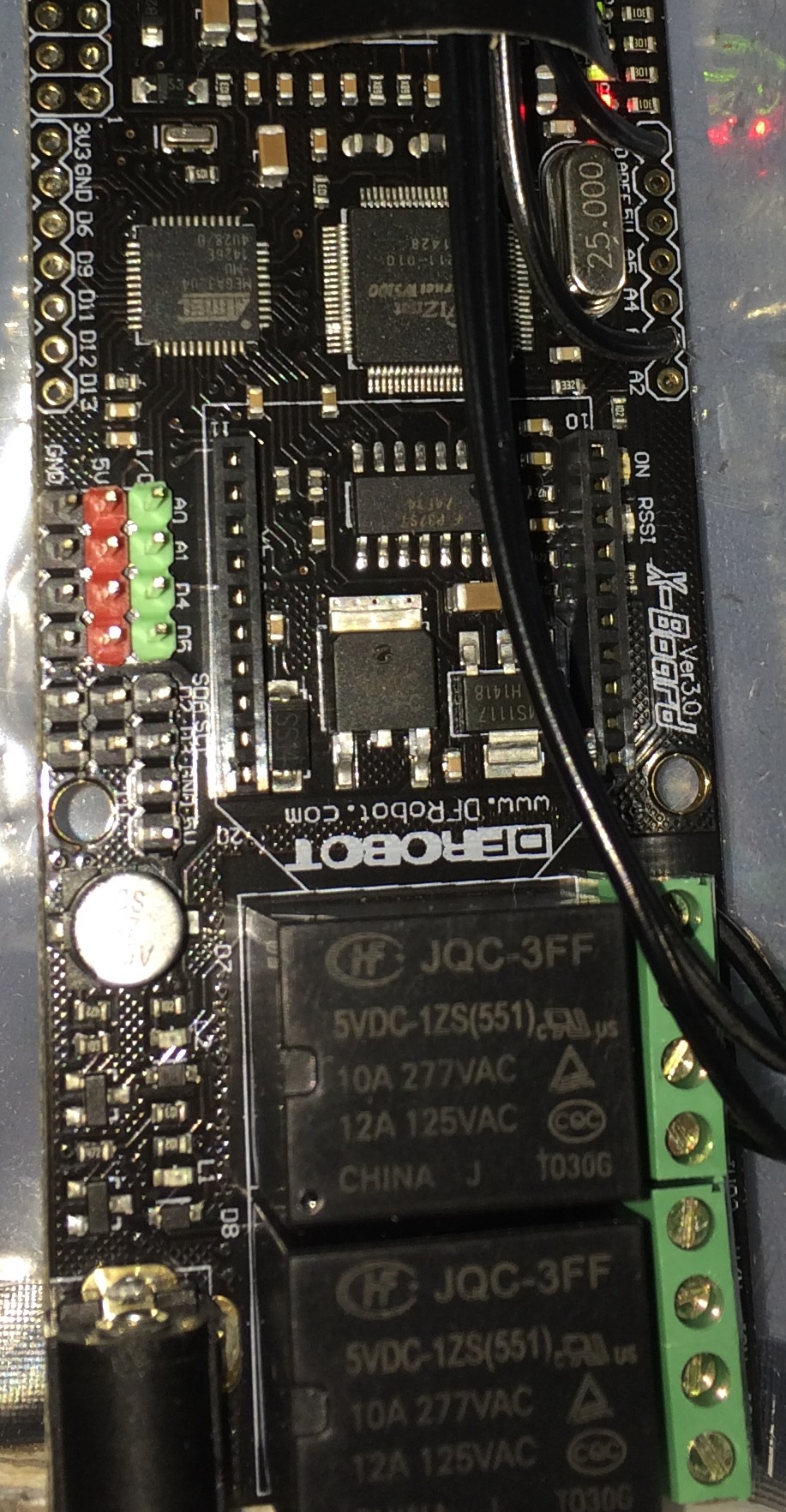

A note relating to the Relay wiring: The instructions show the relay at the end of the board as D7, but in actuality the relay furthest from the end is D7, thus I simply wired my garage door button to the D7 relay, furthest from the end. The board labels the D7 relay as "D7." Therefore, simply put, make sure you're actually wiring your relay to the D7 relay and use status pins A3 and GND for door sensing, as described in the instructions.
A note relating to the sensing pin wiring: After verifying everything works with this code update, I made one minor adjustment as to how I wire the sensing pins (two wires). I chose (and tested/verified functionally first) to utilize the GND hole for my sensing wire that exists on the same side of the board as the analog pin 3 (A3). This allowed me to keep the four wires on the same side of the board (two relay wires and two sensing wires: A3 and GND). I've attached the picture of my wiring for the board as described herein.
Therefore, with all this said, this confirms that the DFRobot XBoard Relay board using v2.4 works perfect.
