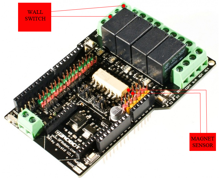

I seem to be running into similar issues like Raul. I follow the PDF instructions to the best of my understanding but am still a little confused.
From what I understand, the PDF references older hardware. I have the DFRobot 2.1 and the Arduino Ethernet. Is it possible for ANYONE to post a top
view picture of the DFRobot with all the connections made for a single garage door, nothing else?
I have the 2 wires coming from the wall switch going to the COM1 lug and the NO1 lug. I have the wires of the magnetic sensor switch on the door going to
Analog pin2(5v) and to the GND right next to it. Thats it. I feel like I'm missing something. I read about a wire going to digital pin 2 but can't make sense out of that.
In the PDF it says Device#- 1 (operated via relay@ COM1/NO1) Pin for relay- Digital Pin #2
Device#- 1(operated via relay @ COM1/NO1) Pins for sensor- Analog pin#2, GND
It says to use the distinct terminal block for each device. I believe this is the area where I'm confused or mis-reading the instructions. If I have the wall switch wires going to the terminal block and the switch wires going to analog2 and ground, Where /how does digital pin 2 come into play?

For the device/door open/close portion, you should have your wires from the wall mount button to COM1/NO1.
For the status sensing portion, you should have your wires from the sensor to Analog#2 and GND.

Postby FACE » Wed Jan 08, 2014 11:07 am
I'm pretty sure that's the way I have it. As simple as this seems to be, it sure is cramping my brain.
Please take a look at what I have and maybe you can spot the problem right off. I have the code set
up like it says in the PDF. Unless I'm interpreting it wrong.. Thanks

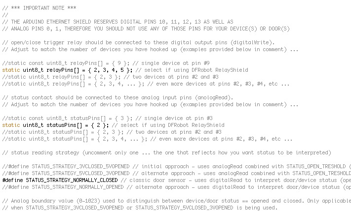

Thanks for the detailed approach. I'm going to have to say there is something wrong with the INO file that I uploaded to the Arduino.
Below is a picture of what my code looks like.
When I apply power to these two boards connected together, instantly I get a click in relay 4 and it remains closed. The LED on the board that indicates relay 4 is closed is also lit up. If I push the manual button on the board to toggle relay 4 nothing happens.
When I touch COM1 and NO1 together, absolutely nothing happens. When I short Analog pin 2 to ground, the board goes into the error mode like in my video. When I un-short these two, the board status goes back to the above. Relay 4 closed and LED4 on.
What I tried to do is to clear the Arduino of any programming to start from scratch to see if maybe I have a bad relay board. I have searched high and low but can't find anything that tells me how to set the Arduino back to factory defaults. The reset button does not clear the INO file out of the memory. If I could do this, I could verify if I have a bad board or not. I did look in the DFRobot 2.1 thread and saw this viewtopic.php?f=5&t=5
Toward the bottom, gokart lists an identical situation. That relay four energizes when power is applied. So again, I'd say it's in my code. I tried to pull the jumper off of
IO3 but this does not disable relay 4. Same exact problems as listed above with this jumper removed.
So I guess what I need help with at this point is for you to review the few lines of my INO file below and also, is there a way to power up the relay board by itself? Not connected to the Arduino? This would also tell me if the board is bad or not. However, everything is pointing to mistakes in my INO file. It's the only thing that makes sense at this point. The chances that I have a bad relay board is slim, I know, but it seems I've created a monster out of something simple only because I don't know anything about it. I do greatly appreciate the help though. I must say I'm learning a lot along the way.

Postby FACE » Sat Jan 11, 2014 11:35 am
Another thing I wanted to add that I don't think I've mentioned throughout this, I am using only COM1 for a single garage door.
I do not have any notifications enabled. This is plain jane one device only. The only code mods I made to the INO file other than what
is listed in the picture is the password and the IP address. Pretty much exactly what it says in the instruction PDF nothing more.
