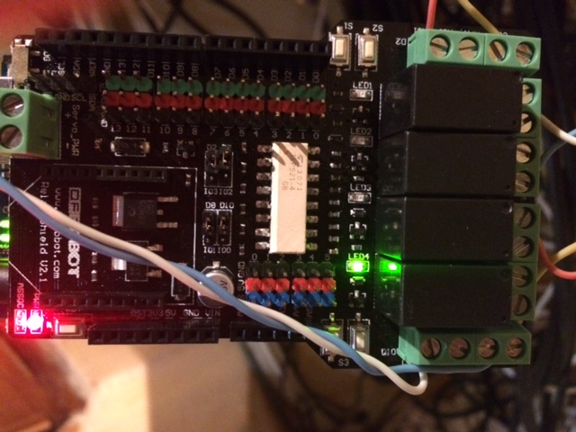

I have a problem making work relays, everything else is working, relay shield, I can access arduino xml, app communicates with arduino, but relay don't answer to button push.
I receive so much warnings while compiling, can be these the problem? Compiling with Arduino 1.0.4
Hardware: Arduino Ethernet + DFRobot Relay shield.
Pasted the output:

Hi Support,
Changing compiling computer this problem was solved but a new one appear. Now there isn't error compiling, and relay 1 from iphone is working fine, but I have in iphone app configured 4 relays:
1 Controller with devices:
Device 1 Relay Pin Number 2 - Working.
Device 2 Relay Pin Number 3 - NOT Working
Device 3 Relay Pin Number 4 - NOT Working
Device 4 Relay Pin Number 5 - NOT Working
When I push on Toggle button in device 2 3 and 4 I don't hear the relay "click", and led corresponding relay 4 in DFRobot shield is always on. Manually test pressing button on relay shield works fine and "click" is heard.

I don't know which is the correct relay PIN, but in instructions says DFROBOT RELAY 1 is RELAY PIN 2 in iphone app and is working fine, so:
RELAY 1 = RELAY PIN 2 Iphone App
RELAY 2 = RELAY PIN 3 Iphone App
RELAY 3 = RELAY PIN 4 Iphone App
RELAY 4 = RELAY PIN 5 Iphone App
I have this configuration into iphone app and is only working fine relay 1. If there is something wrong please let me know.

The latest version (2.1) of the DFRobot RelayShield uses a different pin configuration. If you look at the following Wiki
reference from DFRobot ...
http://www.dfrobot.com/wiki/index.php/R ... DFR0144%29
... The default pins to control the relays (for that version of the RelayShield) are now #2, #7, #8 and #10. Therefore,
you should change the iPhone app configuration for your devices 2, 3 & 4. You will also need to change the INO (Arduino)
code to update the relayPins array definition (near line #71). It will need to match the actual pins your hardware uses.
From the above Wiki document, they explain how you can change the default pins, so you should follow that for your 4th
device, which by default, is set to operate using pin #10. Pin #10 is reserved for the operation of the Ethernet portion of
the circuitry so you'll have to change relay 4 to operate using another pin #.
