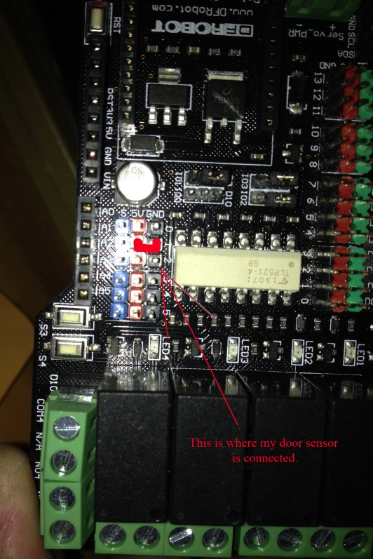

Faulty sensor? No. UNLESS, I have the sensor on the wrong pins? Take a look at the attached picture.
Thoughts?

As for your sensor issue, you probably have the wires on the wrong pins. First off, what type
of sensor are you using? Not sure about your picture ... What's that red mark that looks like
a drawn jumper ?
The circuitry for status sensing is very simple. Have a wire run from A2 to GND. When this
loop is closed, the system knows the door is closed. When this loop is opened (broken), the
system knows the door is opened.
Not really sure how those inner BLUE/RED/BLACK pin blocks work. May I suggest you
connect to the BLACK GND and A2 connectors along the side of the board instead ...
Try that out and see if that works.

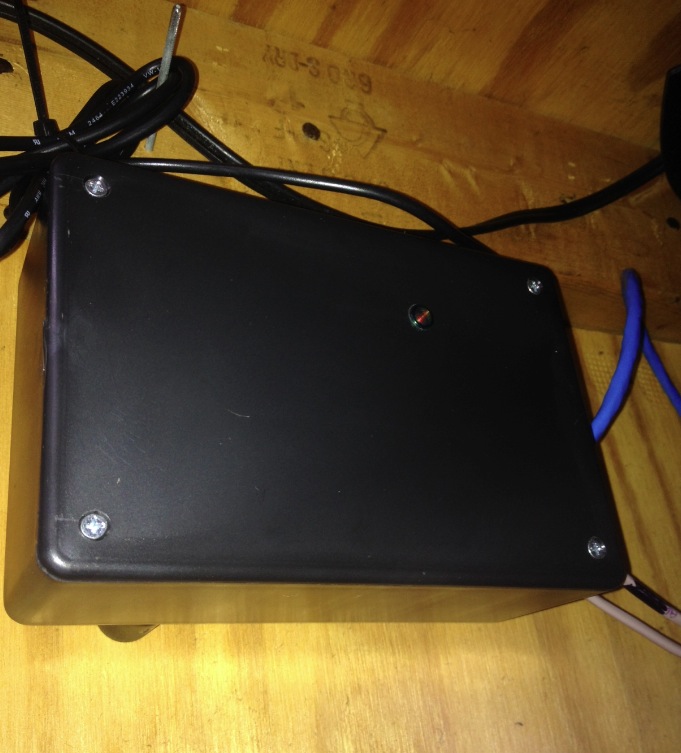

Just got done installing everything into a nice little project box.
Thought you guys might like to see it. I added a light pipe and installed it right
over the power on LED of the relay board. Turned out good.
Thanks again for all the help.
