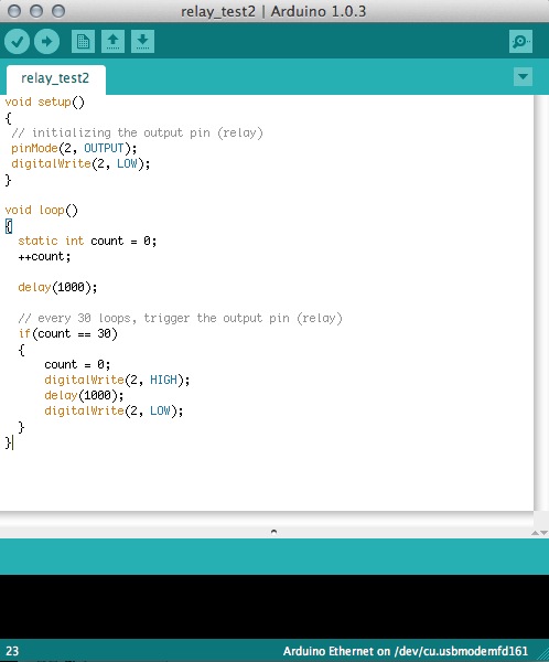

I did as advised. Once I apply power, the standard lights come on. In about 30 seconds the relay goes closed and the LED comes on.
It stays closed for about a second then goes open again and the LED goes off. In about 30 seconds it repeats this process.
Side by side I understand the differences in the code now.

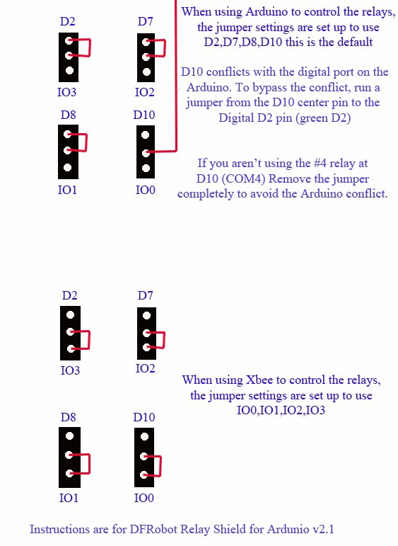

After doing some more research and reading various other forums on the DFRobot v2.1, I came up with the following attachment
as an explanation of exactly what the jumpers are for. I also got a reply from DFRobot tech support. I sort of understand what he is saying, but he didn't
completely answer my question. I believe the language barrier makes it a little difficult to interpret properly. I think with what I found, and what he says, we now have an understanding of what the jumpers do. It also looks like you can't share relay functions if you run an Xbee and an Arduino at the same time.
Let me know what you think…
Here's what he said:
Thank you for contacting DFRobot Technical Support.
These 4 jumper caps is connected Digital pins to four relay port.
If you want to change the the different Digital pin or some pin is occupied, you could connect other one to IO0~3 via a wire cable.
It will be very convenient.
Hope it will be helpful. Let us know if you have any problem.
Best Regards,
Grey
--DFRobot Tech Support

Postby support » Thu Jan 23, 2014 8:18 am
Our understanding is that indeed, with the jumpers in place, the digital pins to control
the 4 relays would be 2, 7, 8, 10. But since 10 is conflicting, you'd run a wire between
the middle pole of that jumper block to the D2 pin. What remains unclear is, with that
setup, under what pin would the 4th relay operate?
I believe there's another thread on our forums that already explains the pin #10
issue and how it works when you link it to the D2 pin, etc ...
Typically, you probably don't have 4 devices to control anyways, so just remove the jumper
completely on that jumper block and you'll have 3 working relays at pins 2, 7 & 8.
That's it!
Re: Status pin clarification
Postby FACE » Thu Jan 23, 2014 11:04 am
There is in fact a section here that covered the #10 conflict. Now that we have an understanding about the jumpers,
I don't see any "tweaking" that could be done with them to further my troubleshooting.
From what we've done, I know that by relay board is functioning properly. With the sample code that you gave me,
I was able to run the code in a loop and watch the relay open/close about every 30 seconds.
Correct me if I'm wrong, but I believe my next step is to use your INO file and put the #2 value in like this:
