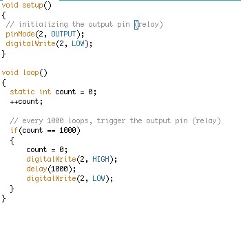

Ok, I've been reading and trying to get this on the right path since this morning. Here's what I've done/found/learned:
I've started with just the wall button. Making the relay actuate when I push the button. I can not activate the relay with an external button
connected to COM1/NO1. I can push the test buttons on the relay and they activate the relays accordingly. I no longer have relay 4 activate when applying power
to the board(s). Since I'm only using COM1 with one device, I removed the jumper off the D10 set of pins to deactivate it. I also read where I could short the middle
pin to the third green pin to be able to use it in the future as it conflicts with "10" of the Arduino ethernet side.
I could find nowhere that tells me what the different jumper settings could potentially be for D2.D7,D8,D10. Since I'm only using D2, it wasn't hard to try each possible position to see
if I could get relay 1 to fire by pushing the wall button. No matter which position I have D2 jumper set to, the relay will not function by pushing the wall button.
I loaded some sample code and went through everything again. I have no difference in the results.
I also changed my code to match the new settings of the V2.1 relay board. Instead of the 2,3,4,5 it is now set to 2,7,8
So as far as this statement goes:
So for the first portion, assuming you have the INO code properly configured and uploaded to your Arduino,
you should have 2 wires, one connected to COM1 and the other connected to NO1. When you touch those 2
wires together, you should be getting a relay clicking on your RelayShield. Typically, these 2 wires would
be attached to your wall mount switch.
I can't get the relay at COM1 to actuate by shorting COM1/NO1 WITH the code below uploaded to the Arduino.
So, as advised, I'll stop here before going to the next step until I can figure this out.

Indeed, what you want to do is copy/paste some code into the Arduino IDE, have it compiled and uploaded
to your Arduino. As soon as you do that, it will start running the functions called setup(), and then loop().
As their names imply, setup() is executed once to have things configured and loop() is executed in a loop
fashion. These are the program entry points. I'd suggest the following code to start with:
Code: Select all
void setup()
 // initializing the output pin (relay)
 pinMode(###, OUTPUT);
 digitalWrite(###, LOW);
void loop()
  static int count = 0;
  ++count;
  // every 1000 loops, trigger the output pin (relay)
  if(count == 1000)
      count = 0;
      digitalWrite(###, HIGH);
      delay(1000);
What the above does is the following:
1) initializes the digital pin ### (you will need to replace '###' to an appropriate digital output pin value (number, ie: 2, 3, 4, 5, ...)
that you want to test/trigger the relay for)
2) every 1000 loops, the digital pin ### will get high for 1 second, therefore you should be hearing the relay click when this happens
Don't leave this program running forever as it will be stressing your relays uselessly, but at least you'll know whether
your hardware is working/connected properly or not.
Once working with this simplistic program (and only then), take note of the value you've assigned to ### and have that value pasted
inside MyDoorOpener.INO, in the relaysPin array definition (near line #72).
That's it ... Hope this helps you getting on track!

I did exactly that. I changed the "xxx" to "2" Compiled it with no errors and uploaded it.
The instant I apply power, relay 1 closes and the relay 1 LED illuminates to indicate the same.
The relay stays closed and the LED remains lit until I remove power. I let it sit in this state with power applied for a few minutes.
I think the relay should close for a second and then open itself again and repeat this cycle every few seconds, not knowing how long it take 1000 loops to complete
I do believe it should not remain closed as it is.
Just for the heck of it, I changed the "xxx" to 7 and then to 8. It did the same thing for rely 2 and relay 3.
Relay goes closed and remains there as soon as power is applied.
